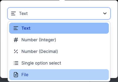

### File fields
We support syncing columns containing a URL as a Noloco `FILE` field. Just open up the corresponding table in your data table and click on the field then change its type to `FILE`. After the table next has a data sync you will see your files at those URLs appearing in Noloco.

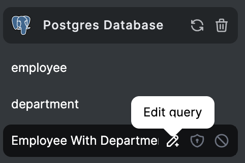

You can add a query table to your app, which creates a new table in your data source, from a custom SQL query. This table will sync with your database, **but will be read-only from Noloco.**
Noloco supports creating a query table by opening up the menu for your data source: ![](https://319575345-files.gitbook.io/~/files/v0/b/gitbook-x-prod.appspot.com/o/spaces%2F-MifpIQWu0HCVYAt51oT%2Fuploads%2Fgit-blob-90d024395c245a9d41610e661378d3f76470bdec%2FScreenshot%202023-03-20%20at%2011.29.52.png?alt=media)

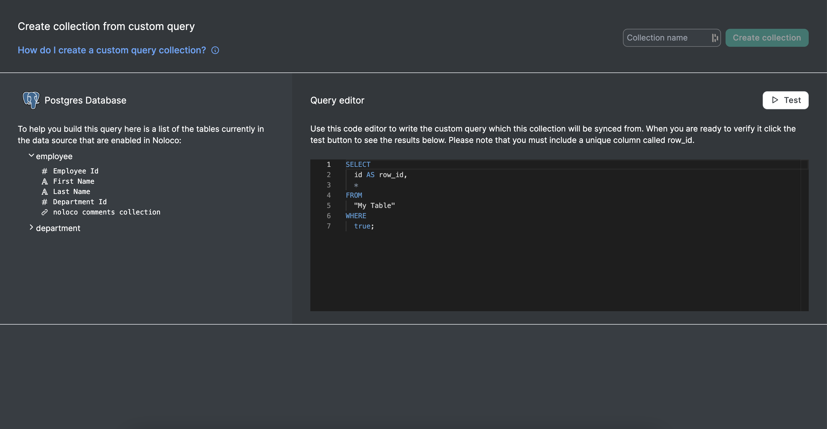

This will take you to the query editor where you can set up the query that will build your table.
<figure><img src="https://319575345-files.gitbook.io/~/files/v0/b/gitbook-x-prod.appspot.com/o/spaces%2F-MifpIQWu0HCVYAt51oT%2Fuploads%2Fgit-blob-aeff1bbc8c5ab38ffcfad262f427d212908fdd46%2FScreenshot%202023-02-02%20at%2018.14.27.png?alt=media" alt=""><figcaption></figcaption></figure>
At the top of this page is an input for you to name your table. On the left you can see an overview of this data source from Noloco and on the right is a query editor for you to develop and test your query over time. The results of testing your query will appear in the section at the bottom of the page. To save your query you must have a successful test of it.

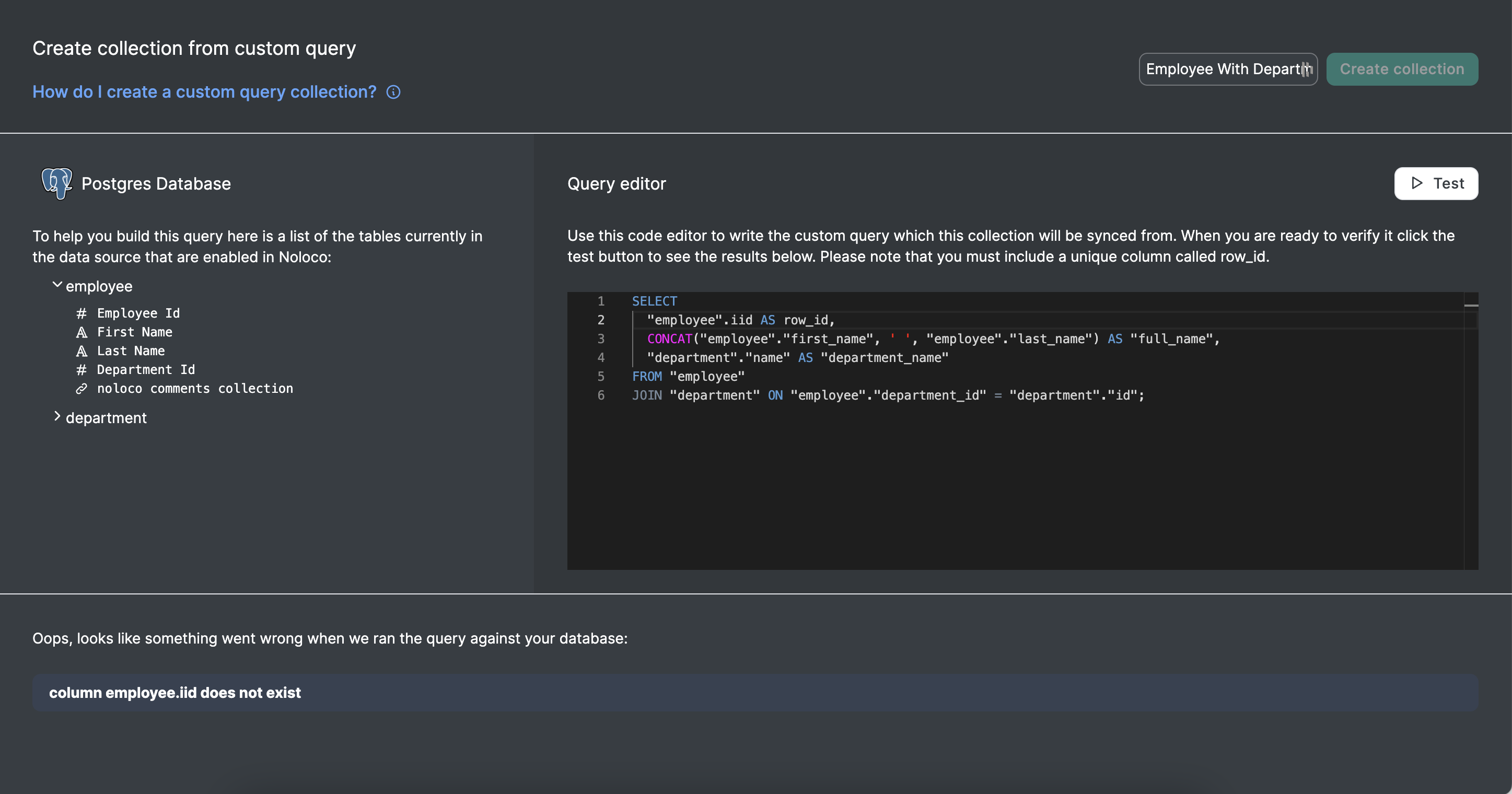

Any errors in your query will be surfaced in the section at the bottom of the page.

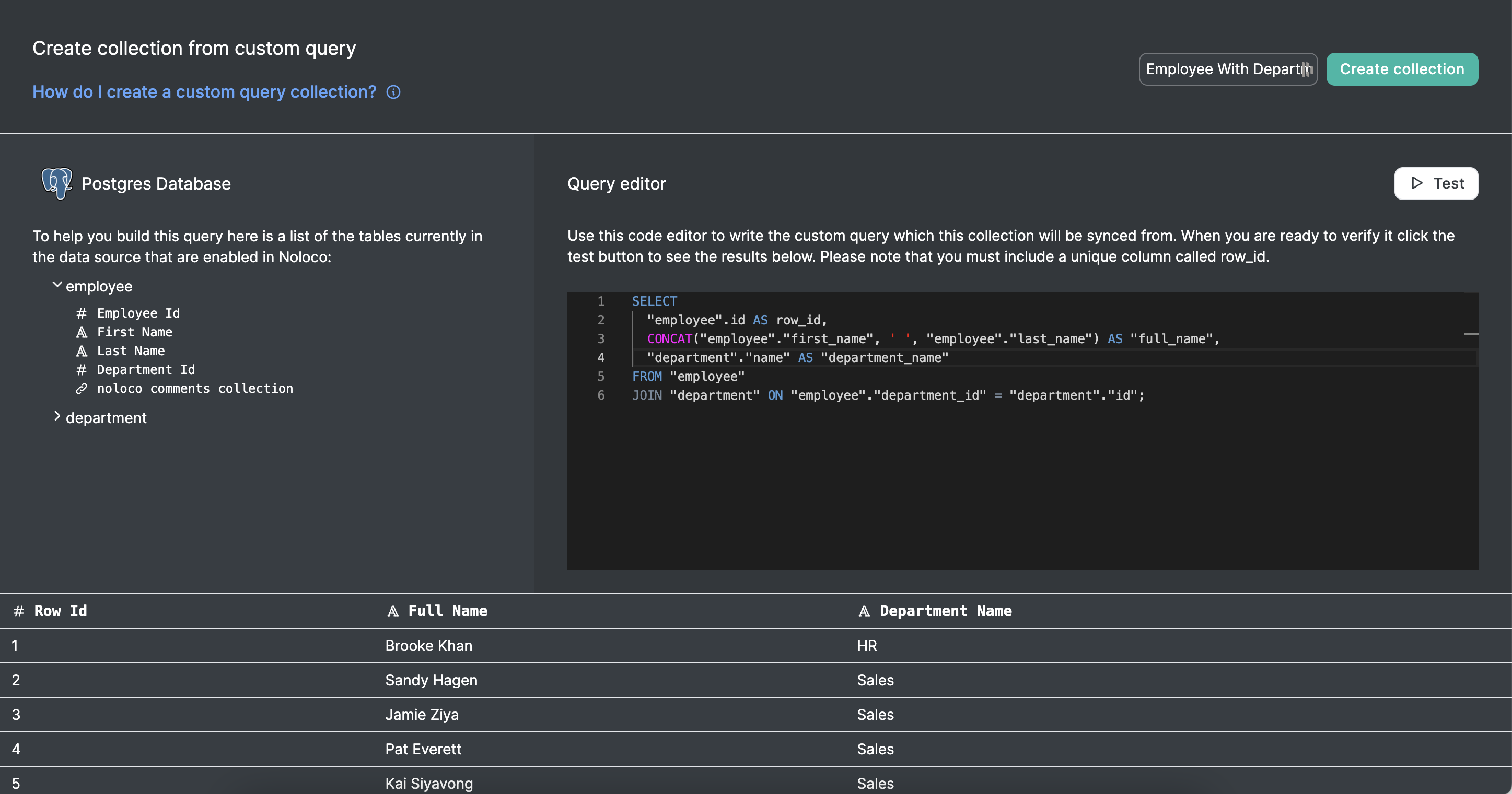

After saving the query you will be able to see and use it like any other data type in Noloco, **except it will be read-only**. It will also be kept in sync with the upstream database both in schema and in data. If you want to edit the query at any time you can do so by clicking on the edit button from the data table.
