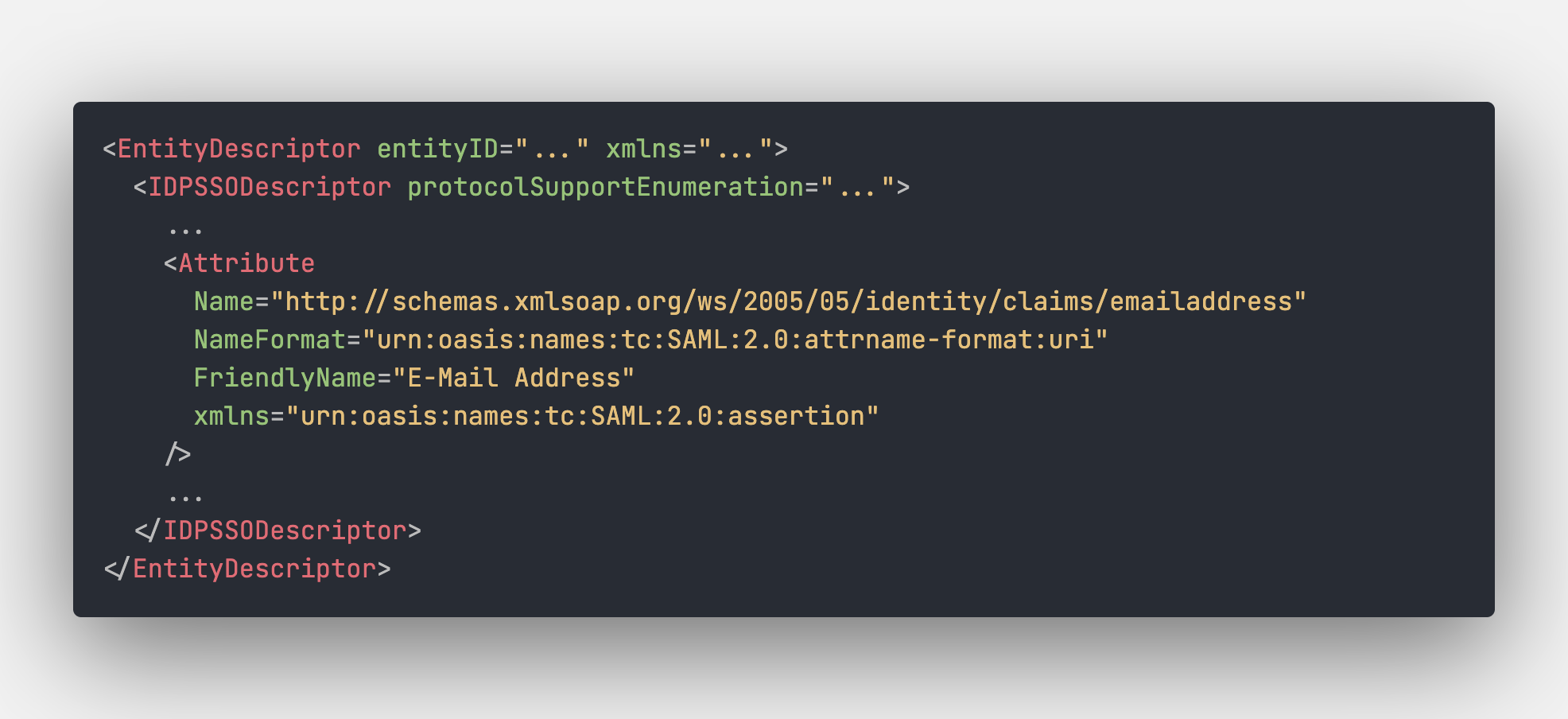

This tells us that the name of the email attribute is: `http://schemas.xmlsoap.org/ws/2005/05/identity/claims/emailaddress`, so we would copy this entire value into the `Email Address Attribute` input in the configuration form.
Alternatively, you might be able to find these in your metadata XML file that you uploaded for the configuration. For the same example, we can see the email attribute:
<figure><img src="https://319575345-files.gitbook.io/~/files/v0/b/gitbook-x-prod.appspot.com/o/spaces%2F-MifpIQWu0HCVYAt51oT%2Fuploads%2Fgit-blob-b6db14444cc070997937083cb37b05f1a8b976a7%2Fcode.png?alt=media" alt=""><figcaption></figcaption></figure>
Note that we do not currently automatically detect attribute mappings, so even if they are in your metadata XML file, you will have to enter them yourself.

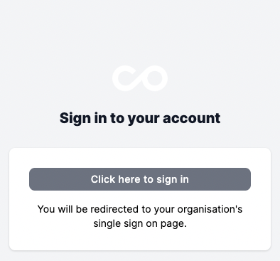

### How your users log in
When your users try to log into your app, they will be redirected to the `/login` page where they will see a redirect out to your IdP.
<figure><img src="https://319575345-files.gitbook.io/~/files/v0/b/gitbook-x-prod.appspot.com/o/spaces%2F-MifpIQWu0HCVYAt51oT%2Fuploads%2Fgit-blob-7f9e874f4680d70ba61e8d076822397c233e9bd0%2FScreenshot%202022-10-11%20at%2015.09.41.png?alt=media" alt=""><figcaption></figcaption></figure>
The `/register`, `/join` and `/forgot` pages will all now also redirect to this login page.
After clicking the sign-in button, they will be taken to your enterprise login page, where they will go through your in-house login flow. After that they will be redirected back to your Noloco app (where if they are new to the app a new user record will be created for them).
